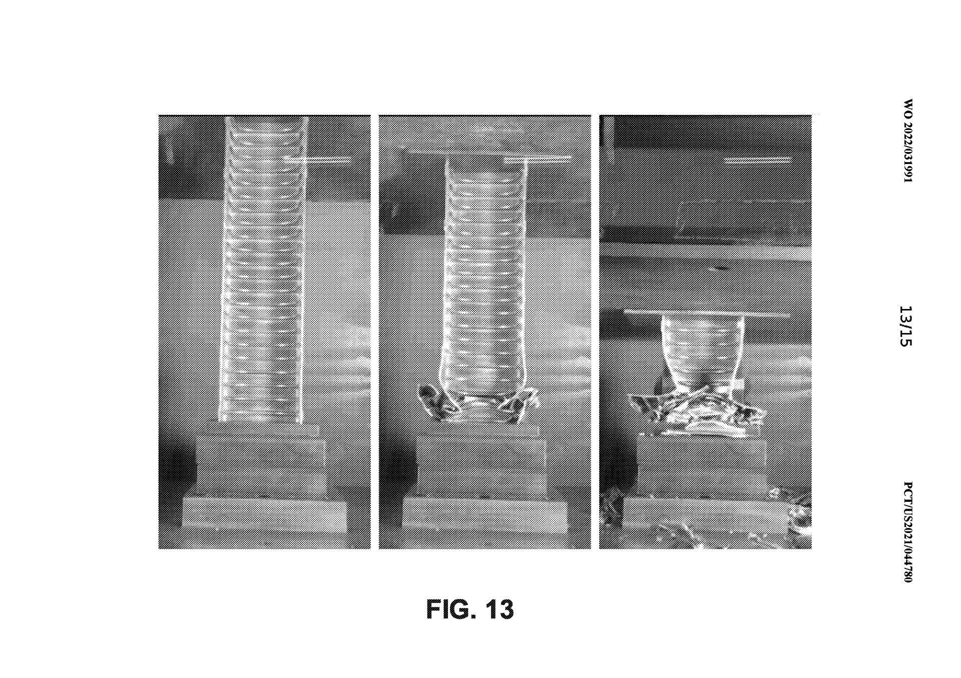

It also has some images of them testing just the webbing parts of the cast separately:
Cybercab Robotaxi Did this fella just realalize he forgot to hit the send button 2 years later. in-the-tesla-model-y-protect-you-in-an-accident_11
Note how the webbing is deformed before the impact area crushes the webbing, even at the top on the middle image. This part of the webbing above and prior to the impact area is also already failing, by design, as this absorbs the energy as it plastically deforms and fractures the material. It's only in the lower section that the failure becomes more visible by the changing geometry.
Remember the energy has to do work in order to deform the material, similar to how huge forces are required by the gigacasting machine to inject molten hot aluminium, the crash also does this in reverse, but just using the force of impact to compress it back into a smaller geometry.
In conclusion there are no replacement cast parts to bolt or weld onto a damaged cast as you claim.
Consider this debunked.
(Alternatively, be courteous enough to other posters here and bring evidence to the contrary, that directly relates to the Tesla cast and design, and is not some "crab analogy")
