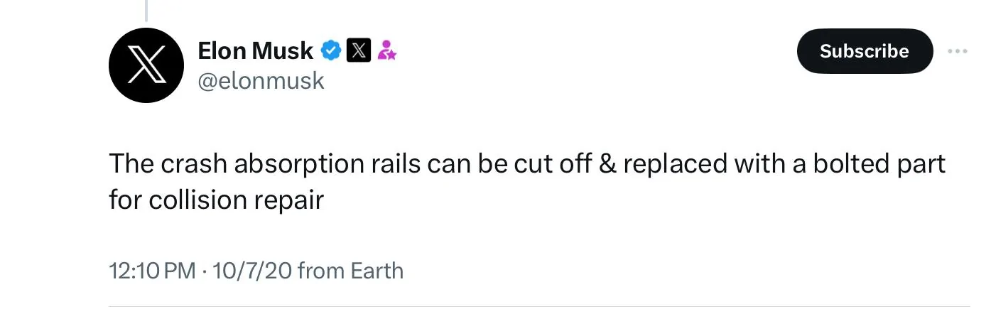

If you would identify what the crash absorbsion rails are, you would know they aren't a part of the cast.
Give me cast specific info and I'll beleive you. The front crash tubes are only good for impacts up to 5-20mph if both are impacted evenly, like on any other modern car.
With a cast you can't tell where it has microfractures, without complete disassembly and a specific x-ray machine.
I don't recall indicating that the crash absorption rails were part of the castings. In most vehicle collisions regardless of ICE or EV where the damage goes beyond the absorption rails the vehicle will be totaled out by insurance.

Then we have Elon’s tweet. He directly says you cut the bad part off (using a Tesla supplied jig) and bold the new piece on.

So in this case, aren't you curious that in the same breath you mention one claim that there is a protective structure in front of the cast to protect it, and in another EM claim that you can cut a part off to replace and bolt a new peice on, that those are in fact the same parts, namely the crush cans, that are in front of the cast? EM doesn't say anything about the cast, just that the crush rails can be replaced. Which is the whole purpose of the crush rails/cans in front of the cast.
