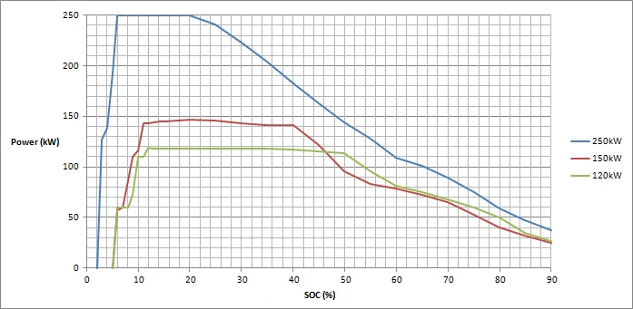

First, I didn’t say average charge speed would be 75 kW. I said half the cars would be charging at 75 kW or less. Thinking on it, that is… probably a bit low. More likely half would be at 100 kW. If you just plug in a destination and follow Tesla’s recommended charging stops, they get you to stops at around 20% and have you leave at a bit below 80% and most stops take 15-20 minutes. At a 250 kW charger, thats when tapering starts and your rate of charge starts going down.
After 5 minutes you are at 50% state of charge and your charge rate is down to 150 kW. After 10 minutes you are at 62% SOC and charging at around 100 kW. After 15 minutes you are at 70% SOC and charging at 75 kW.
I think you get the point. Supercharger stations are not designed to operate at peak capacity continuously. V2 chargers would share 150 kW between them. Every V3 chargers are grouped in 4s and have a similar, but more generous maximum draw which is lower than the peak draw rate. (Numbers are approximate)
Charge curves make this all work; the assumption is that someone on the circuit will be at least halfway through their charge cycle.
Since you never have 40 people roll into an empty station at once, it works.
Thanks for the graph. I've talked to Adjelange about this a few times. He always liked to say that all Teslas charge at 1C from 0-100% SOC. Shame he's not around much anymore.
Anyways do you have a link to a source for more charge rate graphs on different models? I'm doing some calculations to see what the average charge rate is on each.
I've been hearing that the charge cable connector is doing the throttling as it temperature derates when it gets warm. A wet rag helps... dunno sounds a bit dodgy that that is a problem at all.
I’m not sure where the best place to get data on charging curves is. I just dug around a bit to find one. It is something which is surprisingly under-tested on vehicles.
The lithium cells will produce more heat with higher SoC, so input power is throttled. The charge cable can also overheat, but that can happen at any SoC.
I suppose a clever person could cool the cable sensor and trick it into overheating for a faster charge, but that sounds dangerous while holding it by a wet rag.
