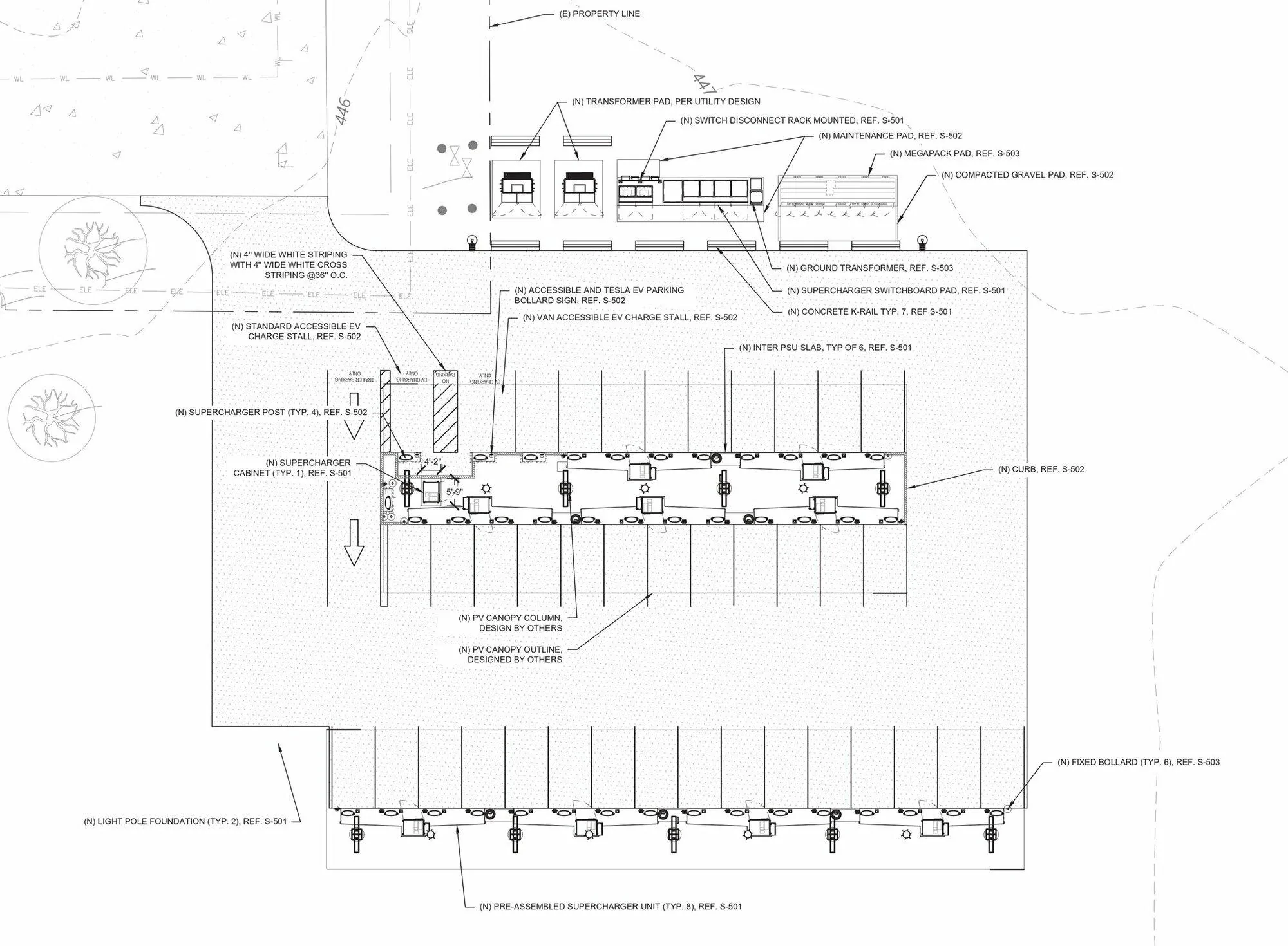

First plans for a Tesla V4 Supercharger designed station submitted for permitting. Things I noticed right off.
  • PV panels planned.
  • Megapack is part of the design which, combined with PV might make this grid independent or at least detachable.

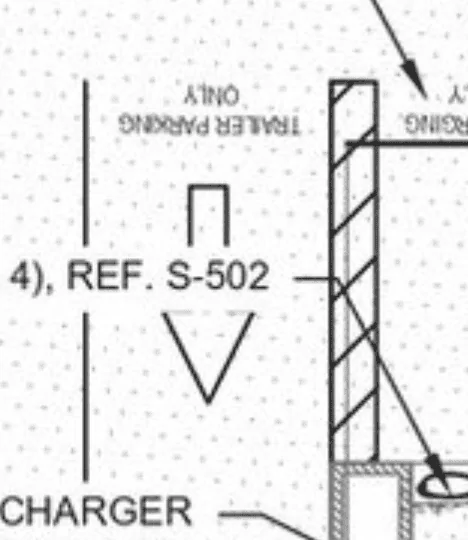

  • Trailer parking is part of the game plan (Cybertruck FTW).

Grid independent? With 42 v4 supercharger stalls @ up to 350 kW each? I don't see how that could happen...I guess it depends on the battery size, but it doesn't look that big on the drawing...

Innovative “pre-assembled“ supercharger!
Tesla are going P&P at SC level. When fail strikes it can swap out and keep charging plugging in a new pre-assembled SC. While the failed unit goes away!
Slick operation

The real question is, what portion of peak traffic is trailers? What portion of traffic is Tesla pulling trailers?
Yep. A solid follow-up question is how fast are the V4 chargers going to be? I mean, if the CT is 10-80 in 15 minutes you could reasonably have 2-3 trucks per hour going through.
I agree that the megapack doesn't look that big on the drawing. They are usually a shipping container filled with batteries, electronics, and cooling. Also, the megapack will mainly serve to balance the load on the grid and to store energy from the PV system.
Certainly not if they are at 100% utilization.
Megapack is 3 Megawatts. That’s enough to charge 37 Model Ys.
