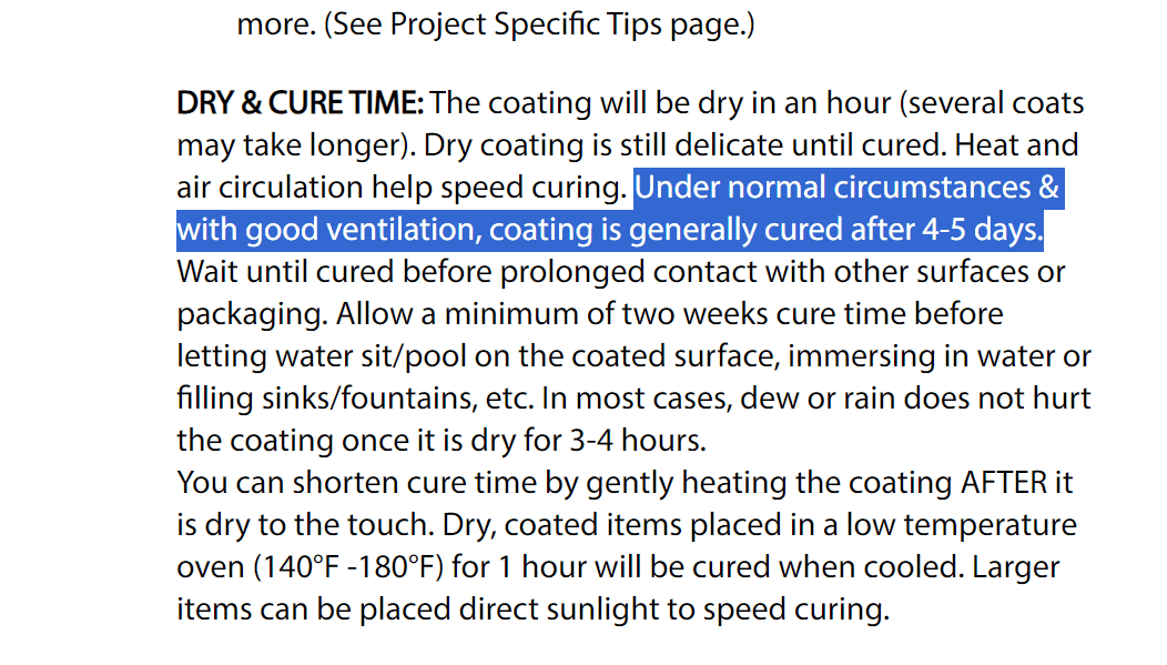

Cybercab Robotaxi Introducing ProtectaClear: the smart coating option to protect your 30X stainless steel factory finish 1706977832970
Am I understanding correctly that the coating takes 4-5 days to cure, but even further shouldn't be allowed to stay wet until two weeks after application?
Also, I can't seem to find information about the recoat times. How long does each coat need to cure before the next coat can be applied? From the information on your site, I'm guessing 3-4 coats would be necessary
That two week suggestion is more for sinks or fountains where water pools. The rain will not be a problem.
as for reapplying, the first coat needs to be dry to the touch before any further coats are applied. Although with one good coat, the Cybertruck will be protected.
So how long would you recommend allowing the truck to cure before driving it? I know it's not exact, but dry to the touch doesn't mean that no road debris will stick to it. Are we talking days or hours at ~72F?
