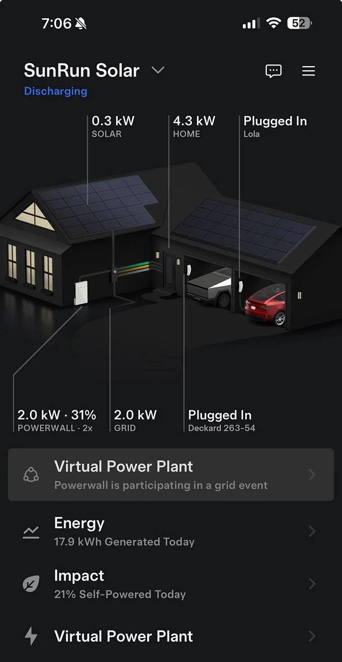

My Gen3 WC and UWC connect to the Tesla app via WiFi for visibility with my PowerWall setup.
When I’m having WiFi issues, I can’t ‘see’ the wall connectors on the Tesla app. They show as “off line”.
Not the end of the world I guess, but it would bug me if the cover caused WiFi issues.
Nice setup! Do you have a WiFi access point in your garage?

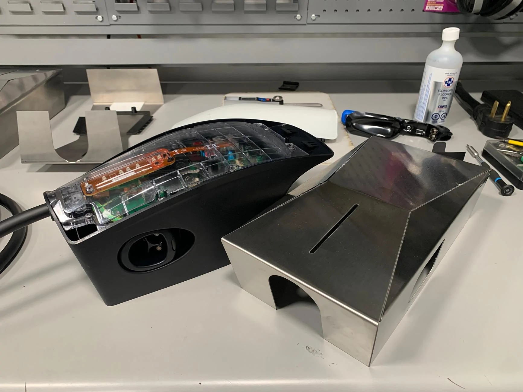

I just received my brand new UWC. This thing is impressive. It is much thicker compared to the gen3 Wall Connector. I've already started designing a version for the UWC. The good thing is the faceplate and the waterproof covers are the same. Besides being deeper, it will also have a relocated cutout for the charging cable.

OP, I’m not sure where the wi-fi antenna is located on the WC/UWC, but any thought to making a small cutout on the Cybercover above it to reduce signal degradation?

Absolutely! Actually for my first prototype I had no cutouts on the top, because I had envisioned the power cable feeding in through the bottom of the wall connector, where I already had a cutout for the charging cable. There might be users out there with a top side entry for the power cable, in that case a cutout is needed anyways to accommodate the power cable coming in.
The antenna is located near the top
