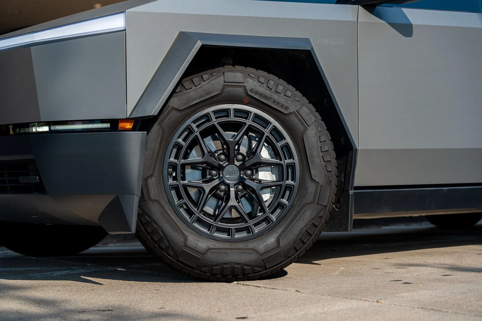

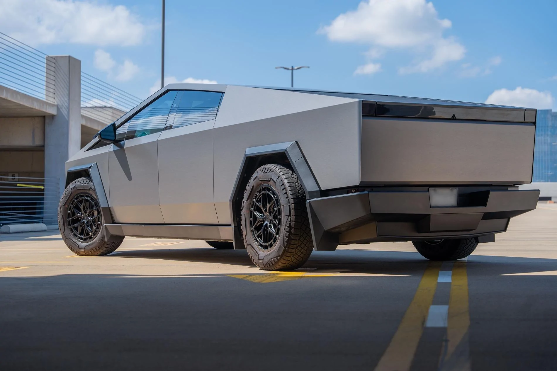

Thanks to @getsometom for reviewing our [AW09] rims for the CT.
https://www.cybertruckownersclub.co...-atomic-wheels-installed-photos-review.19765/
Cybercab Robotaxi Fully Forged Atomic Wheels for Tesla Cybetruck [AW09]-37
Cybercab Robotaxi Fully Forged Atomic Wheels for Tesla Cybetruck [AW09]-18

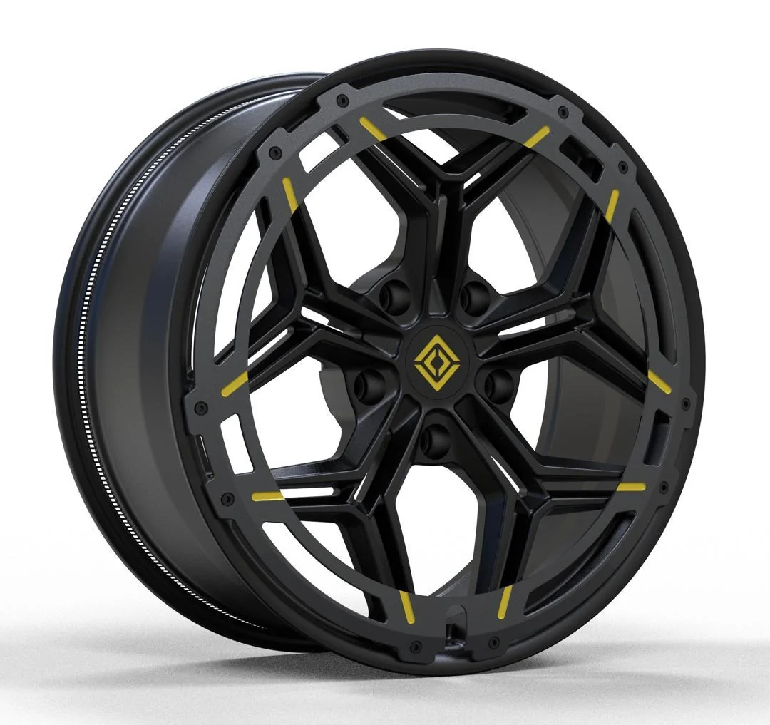

This new design is called [AW08], this render is for Rivians, we will adapt to the CT soon. This wheel has an increased payload of up to 1400 kg vs 1170 kg for [AW09] and [AW10].
Cybercab Robotaxi Fully Forged Atomic Wheels for Tesla Cybetruck 8103678582777a09bee3625d6029d2e0.JPG
Additionally, the valve doesn’t protrude, making the rim more off-road capable. The center cap will have a CT silhouette. This render is for 20”, and we will also offer this design and [AW09] in 18”.

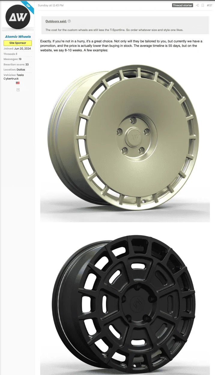

The cost for the custom wheels are still less the T-Sportline. So order whatever size and style one likes.

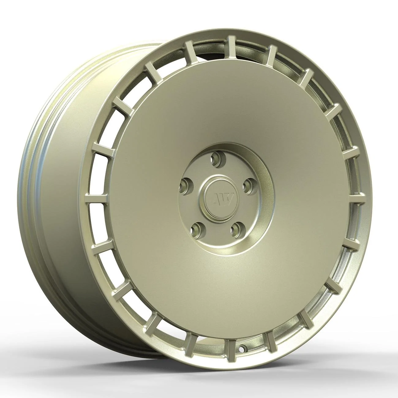

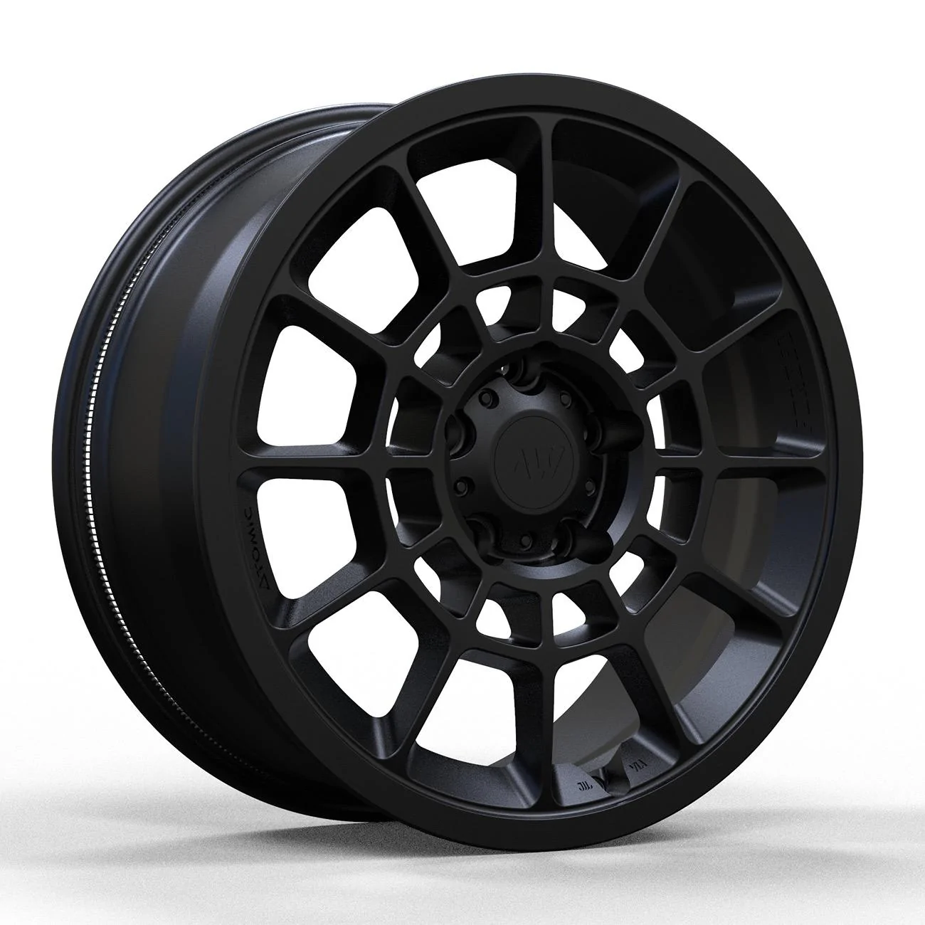

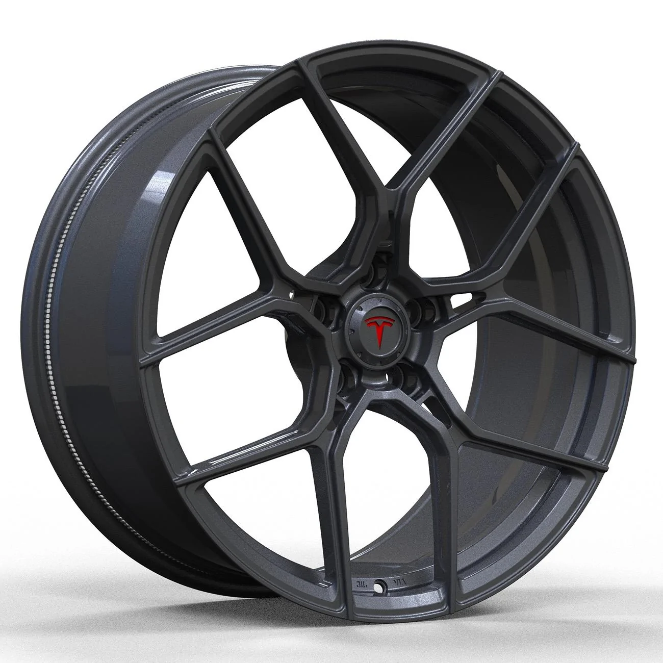

Exactly. If you’re not in a hurry, it’s a great choice. Not only will they be tailored to you, but currently we have a promotion, and the price is actually lower than buying in stock. The average timeline is 55 days, but on the website, we say 8-10 weeks. A few examples:
Cybercab Robotaxi Fully Forged Atomic Wheels for Tesla Cybetruck 5c46f536bcdbf767ba4ccfc2e5e1dcb0.JPG
Cybercab Robotaxi Fully Forged Atomic Wheels for Tesla Cybetruck e535a976dcc2b3c784c38db753d0d028.PNG
Cybercab Robotaxi Fully Forged Atomic Wheels for Tesla Cybetruck cb4a96dd0f1acbe9b4559d6983caa554.JPG

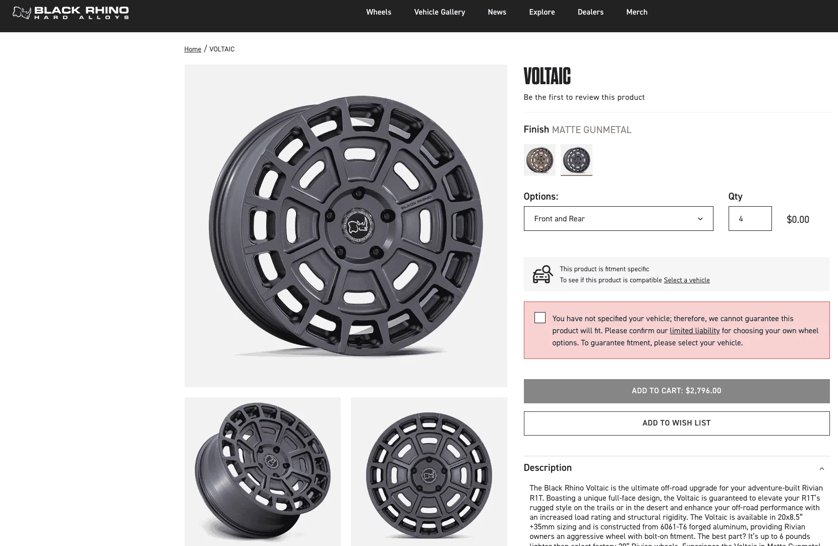

What is this? A dead copy of a Black Rhino Voltaic Wheel? Shame on you @Atomic Wheels
Cybercab Robotaxi Fully Forged Atomic Wheels for Tesla Cybetruck PNG image
Cybercab Robotaxi Fully Forged Atomic Wheels for Tesla Cybetruck Screenshot 2024-07-02 at 11.39.54 AM
Black Rhino manufactures in China too, but at least their spec is dead on for the vehicle application.

...Because they didn't know the centerbore of the CT to begin with! "Experimenting and picking random centerbores" ?‍♂ Lugcentric is a NO NO. Even more dangerous on a truck with a gross vehicle weight rating of 9,169lbs! Inevitable for a stud to snap.
PSA: Another company manufacturing in China with little to no knowledge about wheel engineering.​
@DeadSetElectric You're 100% right. Their stated load rating is underrated for a CT. Forged or not. Even the factory 20" wheels have a higher load rating. Load should never be overlooked, especially with a truck this heavy.
Hard pass.
And yes, I'm a wheel nerd. Have put aftermarket wheels from HRE, Vossen, Black Rhino, , Vorsteiner and T Sportline, etc. on my last 20 vehicles.

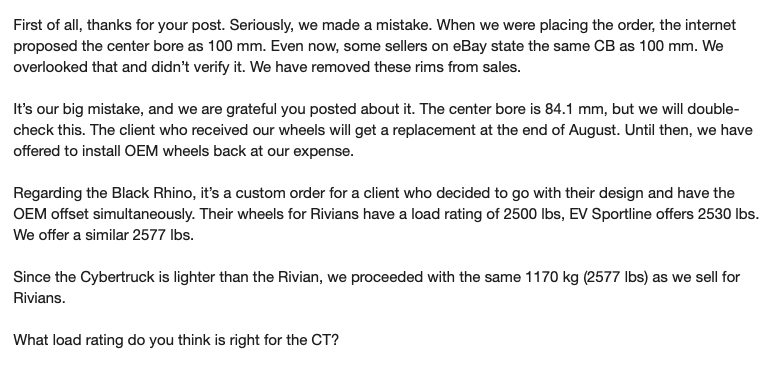

First of all, thanks for your post. Seriously, we made a mistake. When we were placing the order, the internet proposed the center bore as 100 mm. Even now, some sellers on eBay state the same CB as 100 mm. We overlooked that and didn’t verify it. We have removed these rims from sales.
It’s our big mistake, and we are grateful you posted about it. The center bore is 84.1 mm, but we will double-check this. The client who received our wheels will get a replacement at the end of August. Until then, we have offered to install OEM wheels back at our expense.
Regarding the Black Rhino, it’s a custom order for a client who decided to go with their design and have the OEM offset simultaneously. Their wheels for Rivians have a load rating of 2500 lbs, EV Sportline offers 2530 lbs. We offer a similar 2577 lbs.
Since the Cybertruck is lighter than the Rivian, we proceeded with the same 1170 kg (2577 lbs) as we sell for Rivians.
What load rating do you think is right for the CT?
