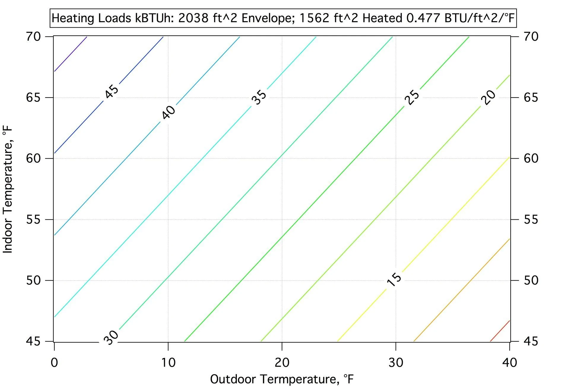

I'll explain briefly how the wise man sizes his heating system and then relate that to how long a properly sized heating system can be run on 5 Powerwalls. As an example I'll use the project I am doing now which is a 2000 ft^2 garage/storage/workshop building with about 3/4 of that heated space. We start with a Manual J calculation which shows the building leaks 0.477 BTUh per square foot per degree rise. This quickly leads to a diagram like this one which shows heating load against inside and outside air temperatures:
Cybercab Robotaxi EV sales have doubled. Is a ‘tidal wave’ coming? kBTUhLoads

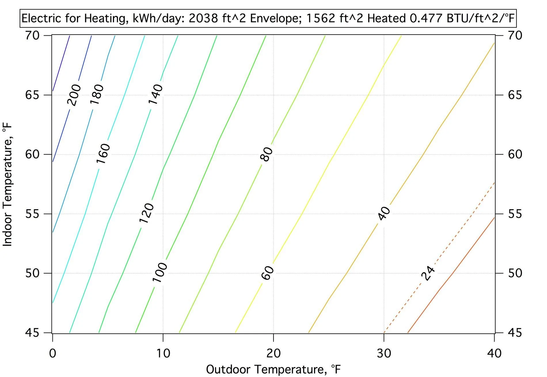

Obviously one should size for the coldest parts of the year during which time, in my area temperatures tend to hover around freezing during the day and dip below that at night. 0 is seldom reached but 10 °F is not that uncommon (5 days a year at night) nor is 15 °F (10 da/yr) so it's clear that a 45 kBtuh system is a good choice. During the daytime when the temperatures are around 30 °F it would run at about 50% duty cycle (of course the modern ones don't do "duty cycle" as such - they adjust motor speed to move more or less refrigerant per hour). Now one can, of course, spend a lot more time on thinking about say a 40 kBTU system with E-heat etc but that gets into additional analysis which probably isn't necessary. I chose 47 kBTU total split pack heat pumps (with propane backup).
The electric load required to supply the heat is easily calculated:
Cybercab Robotaxi EV sales have doubled. Is a ‘tidal wave’ coming? kWhdaLoads
The only comments I'll make on this are that the curves are steeper at the left side of the plot than on the right because COP falls off as the outside temperature drops. The other comment is on the 24 kWh/da dotted curve. I stuck that in there because that is the power I am estimating that I will have available in December (the building has no grid connection). I am using this as a garage and so 50 °F for the indoor setting is fine and I'll be able to maintain that as long as the outdoor temperature is above 30 and when it isn't I can shut off heating to some of the areas (storage) and/or heat them with the E-heat system. Looking forward to collecting some data on this system this winter!

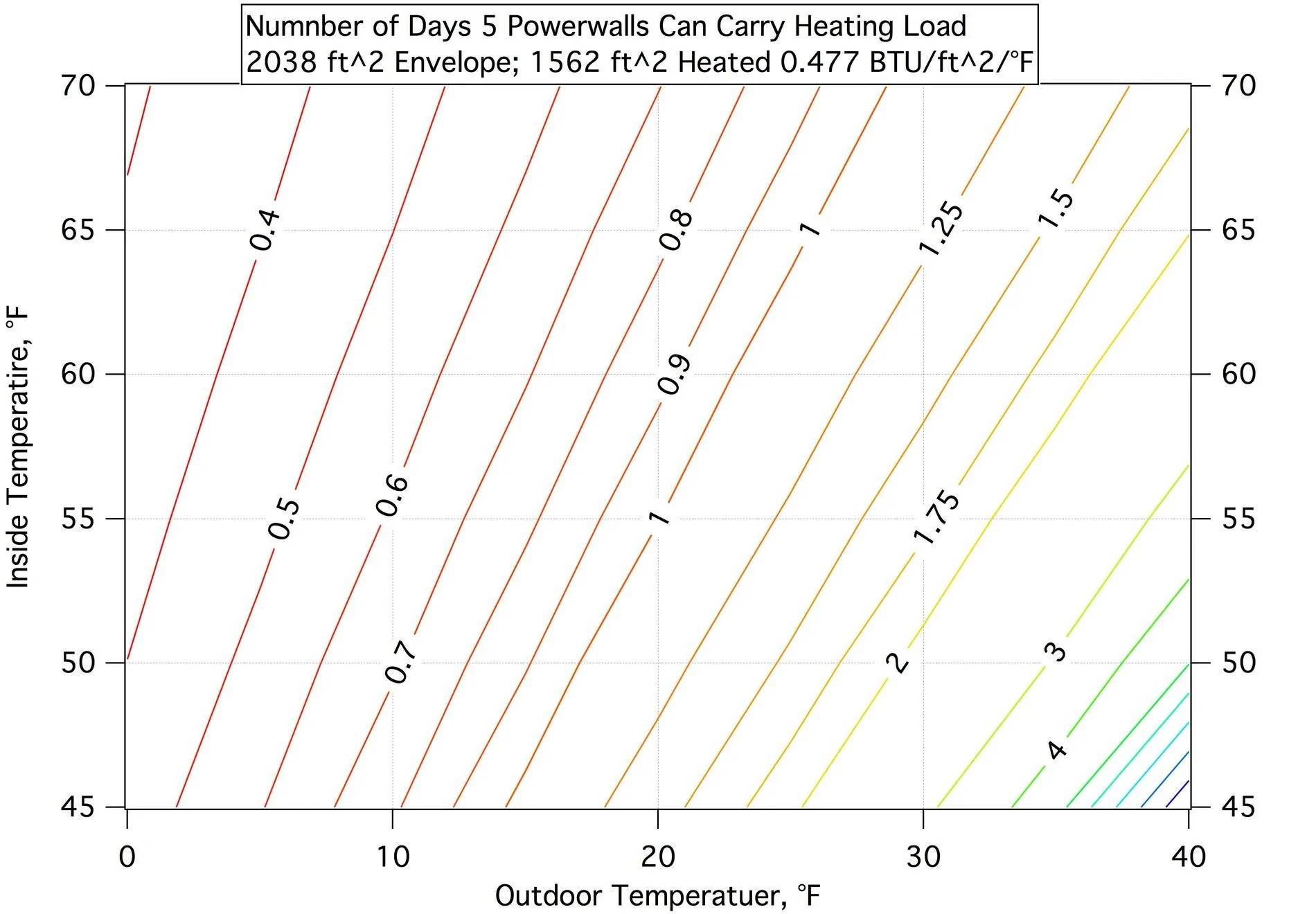

Final step gets to the question which I think is at the heart of this particular diversion to the main thread: how long could 5 Powerwalls run this heating system in the event of an extended outage. That's easily calculated knowing how much energy a Powerwall stores which is 13.5 kWh.
Cybercab Robotaxi EV sales have doubled. Is a ‘tidal wave’ coming? DaysLoad
This chart is clearly bad news for those who fancy that they can run even a small house in Zone 3, 4 or 5 for days on a couple of Powerwalls. But for me it is really good news. I can set all the thermostats for 50 °F and as long as the temperature stays above freezing run forever on solar even if the sun goes in for 3 days. But of course I wouldn't do that if I knew a cold snap was on the way. I'd set some of the rooms to 45 or even 40 and pick up a day right there.
Now of course the same strategies apply to someone in a residence of this size. They would have 1.25 days coverage if they set the themostats to 65 °F rather than 70° F at 30 °F outside. Some may live in warmer climates and it may be possible to get load coefficients down to less than 0.477. Clearly if that can be halved, the times would double.

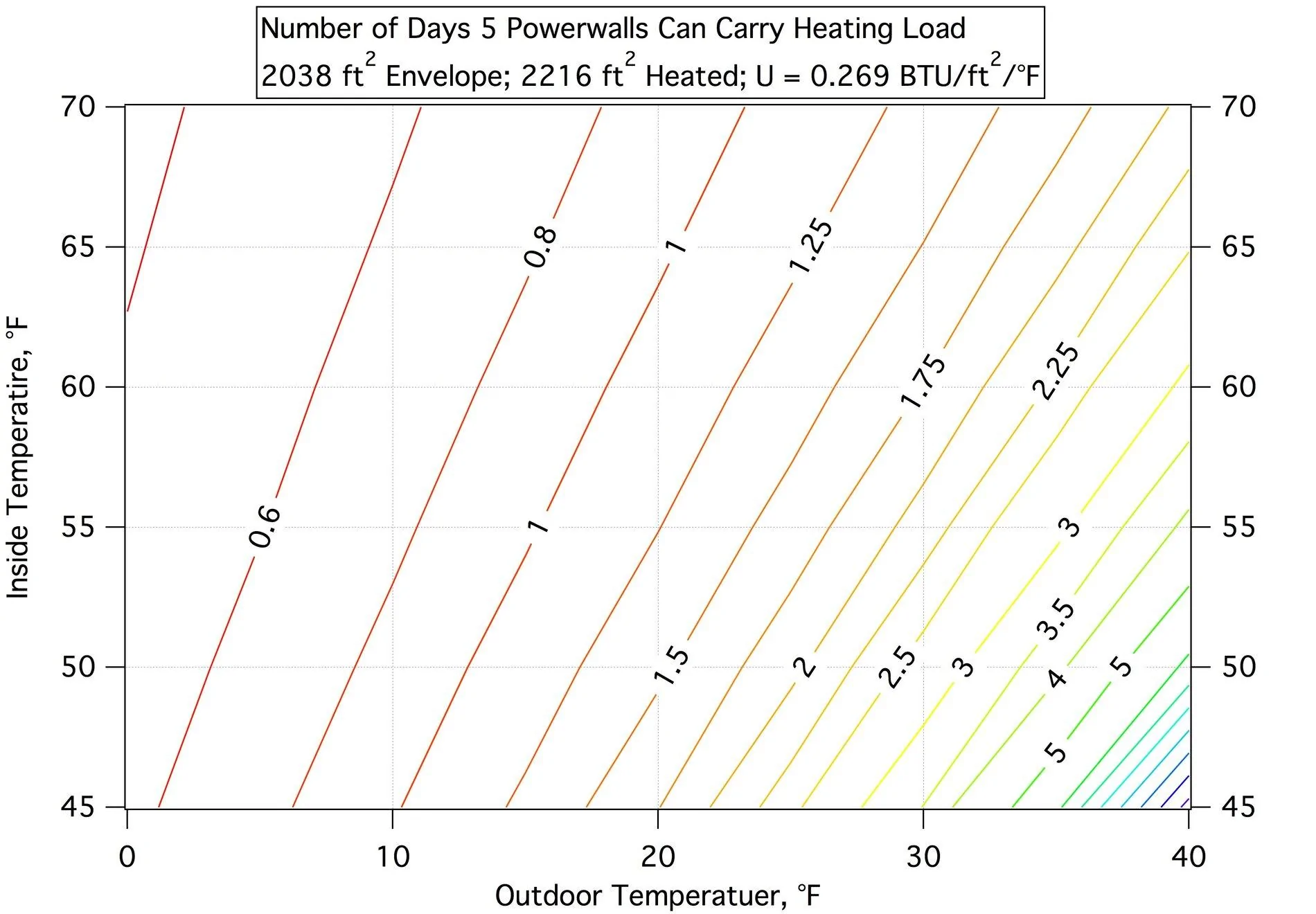

Ummm. People just don't seem to realize that batteries are not very inefficient practical storage media for energy. You really have to push some numbers relevant to your particular situation before coming to conclusions about batteries. I'm doing a 2000 ft^2 solar garage with 5 Powerwalls. This is a tight building (spray insulation in all exterior walls, under the roof, insulation on slab, low e doors and windows, tight construction....) for a very good heating U = .269 BTUH/ft^2/°. I'm using Mitsubishi high COP split packs, COP(45°F) = 4.14; COP(17°F) = 2.53, and expect to see this sort of performance:
Cybercab Robotaxi EV sales have doubled. Is a ‘tidal wave’ coming? PWHours
ACCA uses a design temperature of 16 °F for my region (and room temperature of 68 °F). Were this a residence that I wanted to keep at 70 °F clearly 5 Powerwalls wouldn't carry me long in a run of cloudy days at the design temperature. But in January, the coldest month in my area, the average temperature is 34 °F and I'd be good for 2 days with no sun. But of course one doesn't design for the average temperature. He designs for the design temperature because he wants to be prepared for that (a point that our correspondent doesn't seem to be able to grasp). So clearly 5 Powerwalls isn't sufficient capacity for a residence in my area unless he as backup, is willing to go to a hotel etc.
But this isn't a residence. It's a garage and I'd like to keep it at about 50 °F. As long as the temperature stays at and above average I'll make it on sun alone even in January but, of course, it doesn't. For example, in the last 11 years, the average daily temperature in January has stayed at or below 25°F for 3 or more days in a row 17 times. Obviously I'd be in trouble if any of those cold snaps coincided with a span of low sun! But, of course, I have other strategies (such as backup heat).
Is it better in the summer? U is larger (solar load) at 0.55167 but the rise is only 16 °F (design temp 91 °F, assumed load temp 75 °F) so the design load is only 19560 BTUh. The Mitsubishi's have an EER of over 13 so that means 1.5 kW A/C load which is 36.1 kWh/day. Thus the 5 Powerwalls would only carry me for 1.87 days of no sun were the temperature steady at the design temperature which is better than the 0.8 days they'd carry me in winter but still not very impressive. Clearly there are considerations related to the statistics of the local weather in the summer months which effect the conclusions one draws. But there is another ameliorating aspect to the A/C load as illustrated in this picture:
Cybercab Robotaxi EV sales have doubled. Is a ‘tidal wave’ coming? Sol_AC
These curves clearly show that the A/C load is strongly correlated with the sunshine. If the day's sunshine is weak or non existent the A/C load is reduced. Hence a day of little sun means reduced demand on the Powerwalls. And, of course, the fact that the heavy A/C load presents when the sun does means less shuffling of lithium than is the case with the winter load (which does not show this pattern).
In any case I really don't feel at this point that the summer situation will be very much better than the winter one with respect to the adequacy of 5 Powerwalls. The goal is to have the backup generator run as little as possible. I am now most curious to see how the system will perform in summer (and winter too of course)!
