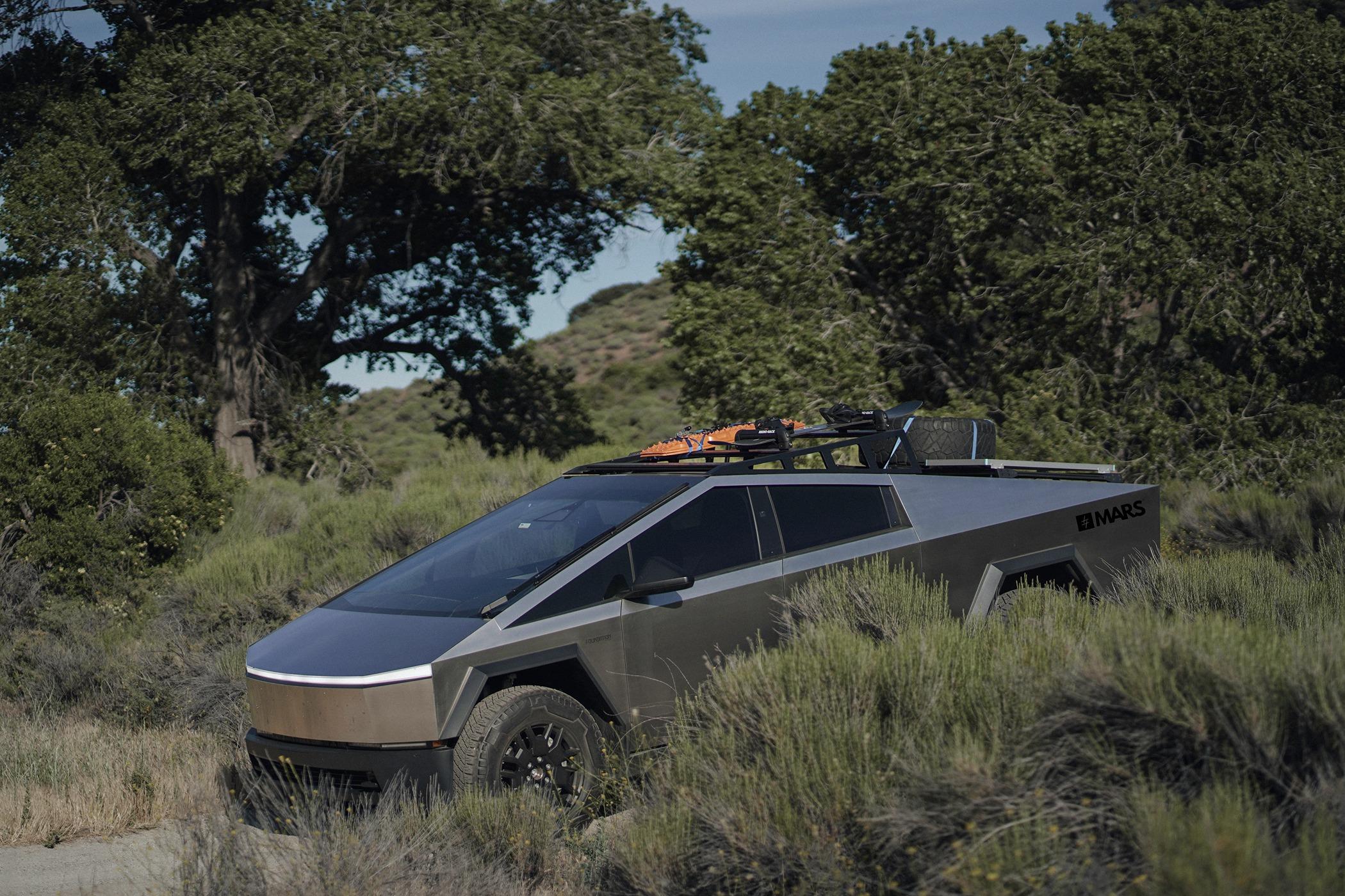

Welcome to Mars Adventure Gear! We are a team of automotive engineers and Cybertruck enthusiasts in California who see immense potential in the Cybertruck. We've designed and engineered a series of products, including a roof rack system, crossbars, side racks, and more exciting products coming soon.
Our goal is to seamlessly integrate these accessories with the futuristic look of your Cybertruck, making them feel like they were meant to be installed and shipped together. Our prototypes have been rigorously tested on long road trips, and we are confident you will appreciate the design and quality when you receive yours. Preorders for our first products are now live, with estimated shipping by June 30, 2024.

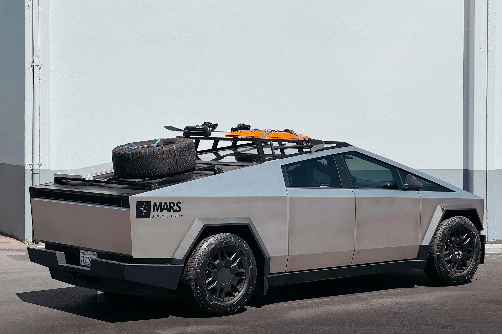

Great question! We actually experimented the adjustable crossbar design and decided to vote it off due to a couple of reasons: the truck is pretty wide makes the cantilever arm long when you have a high load at the center point. To design a adjustable mechanism for the crossbar means a trade off between a really beefy structure for stiffness or you will potentially have a lot of deflection which can damage the glass underneath it. The current design is very low profile (benefits hugely on aero) which is made possible by how stiff the structure is everywhere across the bar. Such adjustable mechanism can also get stuck easily when there's a lot of sand/dirt while off-roading.
Overall we want to keep the design simple & robust - which aligns with adventurous spirit of the brand. The last thing you want when you're out in the wild is a broken crossbar.
With all that being said - we made the crossbar super easy to remove (only 2 bolts) and will be selling the replacement bar itself at BOM cost, in case owners want to have different combinations on their truck. Stay tuned!
