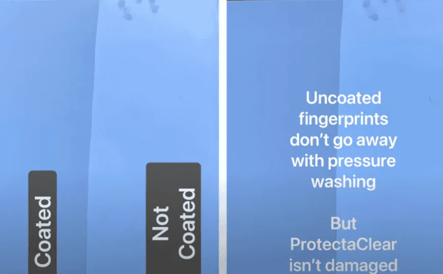

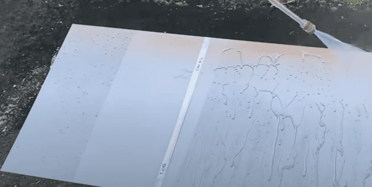

Great news! We tested the ProtectaClear coated panels with a pressure washer and there was no damage to the coating. So you are good to pressure wash your CT.
CHECK OUT THE VIDEO HERE
We tried all of the tips and even the harshest did no damage to the coating on our test panels. See the chart below, we would recommend sticking with the white or green nozzles at a PSI of 1200-2000. But as you can see in the video, we went all the way to red without damaging the coating.
You will see there are fingerprints on the non coated section of the larger panel which were not removed during the pressure washing, however we weren’t trying to clean them, just testing the water pressure to prove the durability of the coating.
Again, we aren't videography professionals, just trying to share our processes with you all. Hopefully this waylays the concerns about washing the CT after coating with ProtectaClear.

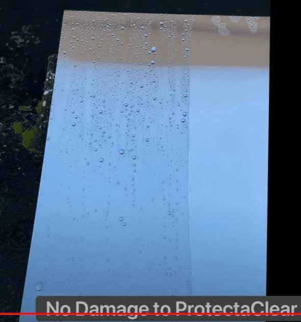

Ok thanks, one other follow up question.
Around 45s it shows the treated and untreated section. Pictured below
Did you wipe off the raw stainless on the right, you can see the fingerprints at the top
It is interesting that there are a lot more water droplets on the left side, is that something you noticed?
Nope, that was both sides wet. The water is just beading up on the ProtectaClear coated side. While it is not truly hydrophobic, you can see throughout the video how the water just beads up and runs off the coated part of the panels.
Ok thanks, in the video it looks like the water falls off the untreated side quickly where the ProtectaClear side has larger and more persistent water droplets. Is it your experience that PC causes some puddling or more persistent water droplets to stay on the stainless? Not a big deal if you are drying the car after but it might contribute to water spots?
