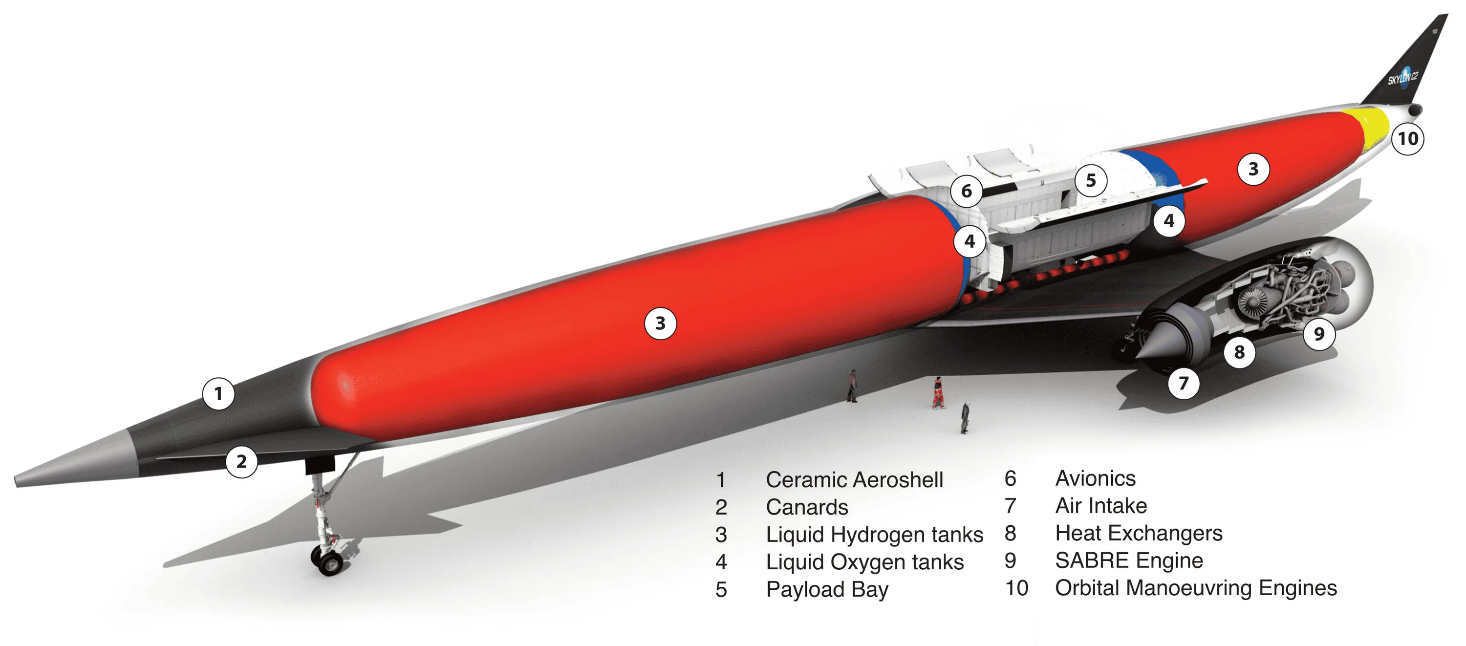

Now if you wanted to make a spaceplane then you can actually use the air/oxygen available whilst you climb through the atmosphere as more than half of your fuel source, instead of carrying an oxidizer with in rocket tanks. Raptor on Starship is around 3.8 parts LOX to 1 part CH4, so you could have a LOX tank probably half the size in comparison, because at higher altitudes where the air is to thin, you will still need thrust to maneuver, so you have to take LOX with too. This is fairly complicated to though, as your engines will have to go through various modes depending on altitude and velocity. SABRE is well on their way at achieving this:
Cybercab Robotaxi Concorde launched micro sat. 1659785942425
As you can see still really a flying fuel tank with limited payload (5) but it does look cool.

If you want wings to make use of the air as a oxidiser and for lift, I'd just go the SABRE engine route. Single reusable launch vehicle that can land and takeoff on a runway. Brilliant. Technically, financially and physically that makes sense in comparison to Falcon, but Starship in another league because they have pushed the mass fraction (3.6%) by making it huge which then works in their favour. There's simply no runways big enough to make that work with wings.
