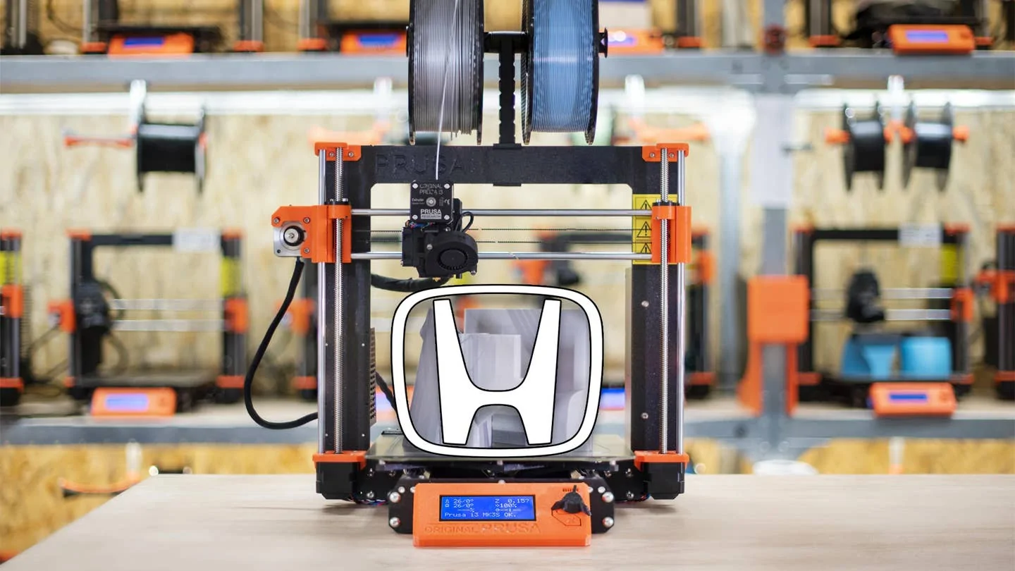

Honda Orders Big Takedown of Honda-Related 3D Printing Models From Maker Communities
Printables removed all models with “Honda” in the listing uploaded prior to March 30, 2022.
by Rob Stumpf | PUBLISHED Apr 13, 2022
Cybercab Robotaxi 3D Printing 20220413-Honda-Prusa-3D-Printin
3D printing has been one of the greatest introductions to the automotive DIY scene in years. I've written about it before, and it's amazing to watch problems get solved with unique solutions from imaginative minds across the globe. What's more, it's great to see car companies embrace the maker community, even supplying the plans to help build and share custom parts.
Unfortunately, not all automakers share that same sentiment.
Recently, I noticed a part that I made for my Honda Accord was removed from Printables, the newly rebranded 3D printing repository offered by Prusa. There seemed to be no rhyme or reason for it, but I didn't think anything else about it...until reports of a mass deletion started popping up on Reddit.
All models referencing the word "Honda" posted prior to March 30, 2022, were seemingly removed from Printables without warning. These included speaker brackets, key housings, hood latches, shifter bushings, washer fluid caps, roof latch handles, and my trunk lid handle—a part not offered on 10th generation Accords sold in the U.S. at all. In fact, many of the removed parts had no Honda branding but were just compatible with Honda vehicles. As it turns out, Prusa says it was issued a takedown notice from Honda and removed all 3D models that referenced the brand.
"I can confirm to you that we have received a letter from a lawyer representing Honda, informing us that we were required to remove any model which used 'Honda' in the listing, the model itself, or one of several trademarks/logos also associated with Honda," a Prusa spokesperson told The Drive in an email. "This will also be related to the naming of the files it self (sic), as for Honda this would be considered as a violation of their trademark/patents."
A Prusa employee responded to a post on the company's forums, noting that Honda sent a "huge legal document" that covered every model that the company wished to have deleted. The document reportedly included items that did not have Honda logos, but also specific items with certain shapes and dimensions—like a washer fluid reservoir cap, for example.
A response from another employee was posted suggesting other sites that host 3D models were also sent a similar takedown notice. These files still remain up on Thingiverse, Thangs, and other repositories at the time of publishing, however...

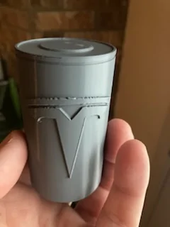

I got this 3D-printed 4680 cell at the unofficial Gigafest party as a door prize. I think it’s broken tho, since it won’t hold a charge

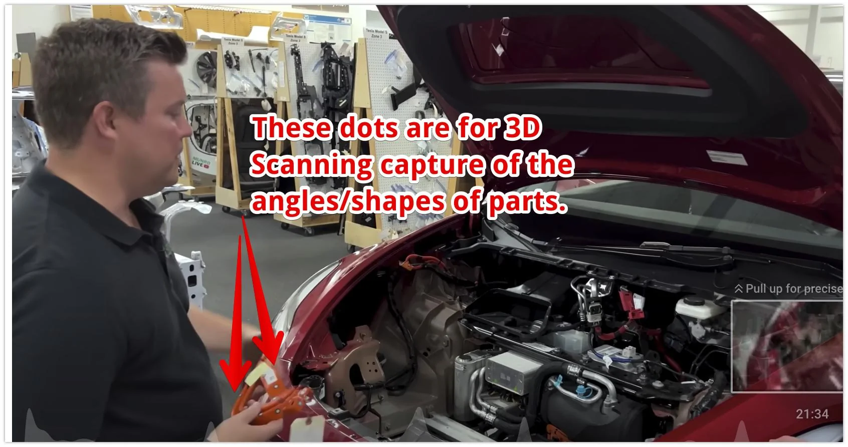

All depends on what your planning to do....
Munro and associates 3D scans the parts to sell files/information to OEM's
