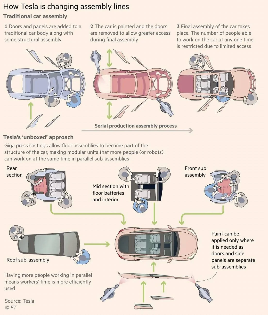

Here's a comparison diagram of the traditional car assembly process vs Tesla's new upcoming 'unboxed' process.
All the people on an assembly line are working in parallel, just on different cars, so where is the advantage?
If it takes an hour to bake a cake, then I can average 1 cake per minute by using 60 ovens.
For vehicles, they are manufactured in "parallel" by having many, many vehicles on the line. If the same result is possible with fewer vehicles in-process, then there will be less capital expenditure on equipment, floor space, etc.
Or, if you prefer: the same vehicles-per-hour can be achieved with a smaller footprint.
So they are claiming, we shall see. It will be hard to judge with the Robotaxi supposedly having 50% fewer parts. I'm not holding my breath. I remember Elon's attempt to speed up production by running robots at warp speed. ?
